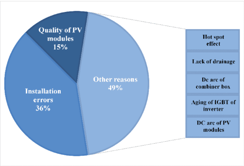

Just found this for solar fires in the UK.
Not many of them in the grand scale of things.
Interesting that isolators are the main culprit.
The Germans prefer to have a DC disconnect on the actual inverter. Hence I don't have them. There is no fusing in the UK to my knowledge on series strings. But I presume an inline locally install fuse box has the same risk as an isolator. I don't have either.

From Tugboat's link to the IEEE article:
Are "lack of drainage" and "DC arc in combiner box" not installation errors?
The other factors could also be exacerbated by poor workmanship during installation.
Combiner boxes are notoriously found to be totally crappy quality in many cases. You can end up with a lot of amps running thru them at the hottest part of the day. I can see a lot of them stressing out and smoking.

We don't have combiner boxes here just straight strings to inverter no fuses and no rapid shutdown.
They are the place where multiple strings come through, that's where the fuses/breakers are located, Surge protection for the strings, string monitoring if it's not done and the rapid shut down isolators if required if it's in the attic and also the earthing bus bar and grounding protection stuff. Some also do the paralleling of strings up as well. If there is DC charging of batteries involved there is a whole load of other stuff in there as well.
They are used a lot in the USA due to a code regulation you have. Before about 10 years ago USA mainly used inverters with transformers and required a separate ground spike to the solar which was bonded across to the main house spike. That then went to the combiner box to be used for the surge protection, array grounding and to the inverter DC side.
The transformer less inverters get the ground from the AC side and as such don't require a dedicated earth spike of their own for the DC side. But the fusing, surge protection, Dc breakers, firemans isolator etc are still being put into combiner boxes. They developed over the years into quite an industry and heavily sold as major safety required items. Each box has colossal amounts of connection points between various components handling some very high currents and voltages. And they like to get them as small as possible which is one of the selling points.
The old transformer inverter setups with battery with all the trunking etc you could easily fill up 2m2 of wall with all the bits and bobs that are now included in the purpose made combiner boxes which come in at under 0.5m2.
German codes require all that external stuff to be included inside the transformer less inverter. Europe has never really used transformer isolating inverters. Plus, it's a different setup because we have 230V/400V 1/3 phases and USA has your split phase setup.
The above is what I know on the subject of combiner boxes and I will admit it may be incomplete or wrong in some parts especially surrounding the earth required onto isolating transformer setups.
