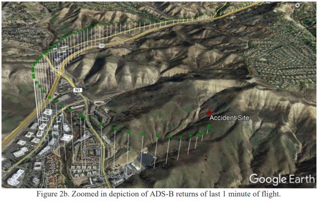

That NTSB report is as usual full of information.
It states the last transmission was that the pilot was climbing up to 4000 ft to make himself visible to radar and be above the cloud layer.
The plot of the last part of the flight seems to bear this out with the helicopter climbing steadily before then for reasons unknown starting a banking dive to the left.
Would it really be that hard to maintain level climbing flight in a straight line??

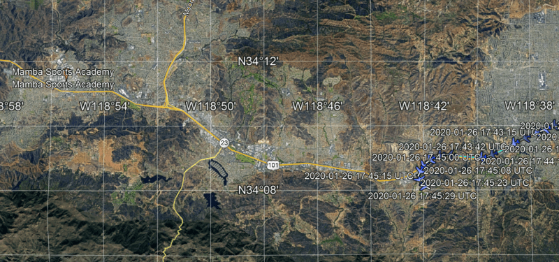

Still seems very odd, particularly these days. 25 years ago, a helicopter might have had to scab a GPS by sticky taping one to the dash, but that helicopter should have had at least the equivalent of a basic Garmin car nav system, which would have shown that they were veering 180 degrees away from their destination. They were following the 101 freeway, and the helicopter was ostensibly visible from the ground, so also vice-versa, and then the pilot turned away from their course in the last 20 seconds.

I get something like a 0.6 g turn; that seems a bit drastic for flying in limited visibility
He still had gobs of instruments telling him the same story, over the course of at least 40 seconds
> GPS moving map
> Attitude display system
> Instrument display system
> Horizontal situation indicator

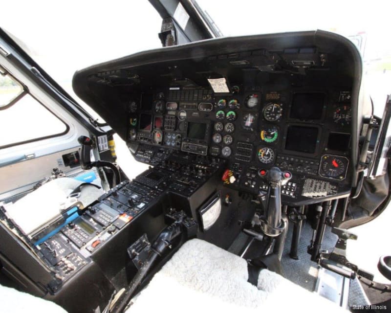

I am under the impression that normally the pilot will have his left hand on the collective and his right hand on the cyclic control.
When the pilot is changing channels on the radio, what is his hand position?
Bill
"Why not the best?"
Jimmy Carter
They can trim the cyclic and also the collective.The left hand is on the collective.
The normal way is to take the hand off the collective for a couple of seconds. Alot of collectives they can change the frequency on a consol on the collective.
You can hear helo pilots getting a bit narked when ATC give them frequency changes while hovering.
He will have been pulling lots of collective to do the IMC escape climb.
This guy day in day out apart from check rides will be flying looking out the window.
here is the cockpit of the helicopter that crashed.
