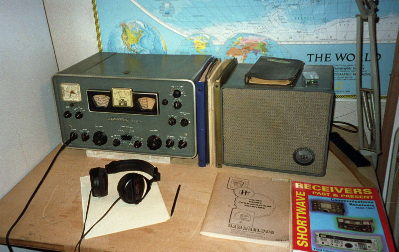

I can relate to this as one of my hobbies is old radios, and my pride and joy, a 1965 Hammarlund HQ-180A, uses vacuum tubes.
When I acquired the radio back in 1999, I needed to replace several of the tubes which were broken. I finally found a guy in Mesa, AZ, who had a warehouse stocked with over a million vacuum tubes. The vast majorities of his inventory came to him when the Pentagon would close a military base and they would literally sell off stuff like that by pound. Since my Hammarlund was based on a military design, I had no problem getting the tubes that I needed.

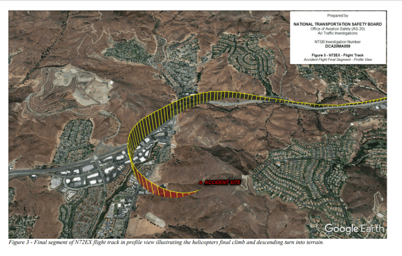

Surprised that the radar shows this chopper turning left, with the altimeter indicating climb.
The man rotor won't support the weight, and you lose elevation.
The only way you'll get that sort of behavior is if you are caught in swiriln cross winds, common in the mountains, with low pressure centers, that would show higher elevation while falling.
its not a radar plot its a radar 24 ADS-B plot. Which has several well known issues especially with a rapidly changing situation. They are all documented by people more knowledgeable about them on the internet.
I just know that you can't trust them, not the tech reasons why.

Fair enough, but the trace shows several right turns, early on, but in the final moments a left turn, and claim of rapid rate of climb.
So the question is why would a chopper try to turn left, when that is not an allowable flight path, and show climbing trajectory when no trained pilot would do that.

Spacial disorientation, as discussed upthread is what people have been thinking.

"but the trace shows several right turns, early on, but in the final moments a left turn, and claim of rapid rate of climb."
hacksaw, where are you getting this data from?
Try looking at and reading the ntsb report
And see figure 2b. I don't see any turn and climb there?
What I see is a climb (believed to be into the cloud layer) , followed by a gradually increasing turn and descent to the left,possibly caused by complete lack of visual horizon and possibly sudden transition from visual to instrument only flying.
