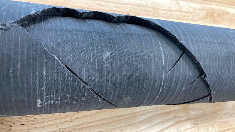

Another Opinion: Design News Jun 23, 2023: Carbon Fiber Is Safe for Submersibles When Properly Applied
Lets not completely discount this technology until all of the facts are in. It may be that the investigation could find fault with Oceangate's implementation, rather than the entire class of "Carbon Fiber Compost" material.
Test Sample Composite Energy Technologies
Link said:
Link said:
provides carbon fiber pressure vessels to commercial and government customers such as the Office of Naval Research that have never failed in their dives to much deeper sites than Titanic, said president Chase Hogoboom in an interview with Design News.
... “We’ve built vessels that we’ve cycled 200 times (to deep-sea pressures) and then brought to implosion and those fail at the same depth as new ones.”
The key is diligence in designing and testing the composite structures, Hogoboom explained. “We have a very high confidence in the strength of what’s been built,” he said. “We use engineering models, but we test to failure to validate what’s been modeled. That’s a crucial step that OceanGate has skipped," according to Hogoboom. “They never brought an exact clone to failure.”

He was told repeatedly that the structure needed to be tested, but he refused to do so, even after the original hull of the Titan didn't come close to meeting lifetime expectations and had to be rebuilt.

The whole health monitoring / acoustic emission patent is IMO nothing but wishful thinking / babbling. There is no way I would rely on AE to predict when a composite part is going to fail. AE might indicate some change in the material, or it might not pick up some change. But good luck determining what the AE signal is indicating. And yes, I’ve read a lot of related research papers over the years. And have run a lot of tests on composites.
