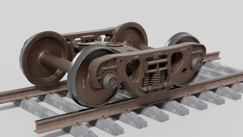

I would guess a failed bearing, rather than an axle. There was a hot box detector 20 miles before the crash site that apparently alerted to a possible problem. Very near the crash site, there was another that said there very definitely was a problem. And then the train crashed.
It's not clear to me where the doorbell camera was, other than being between the two detectors.
spsalso

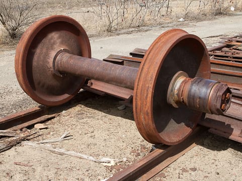

spsalso's video shows the heat resulting on the axle running on the bearing housing (or perhaps the bogie frame). Eventually either the axle will cut it's way through the bogie or the end of the axle will be removed. Either-way once one axle looses it's connection to the bogie, The game is over.

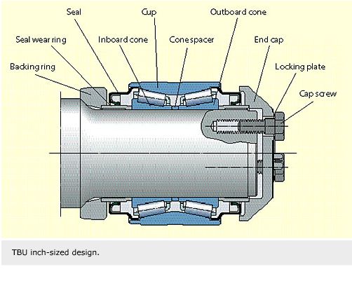

There are no modern cars having plane journal bearings, so we may have a rare roller bearing failure.
title-49 section-215.115 Roller Bearing Periodic inspection Requirements
Timken's service limits for some of it's rail car axle bearings attached.
