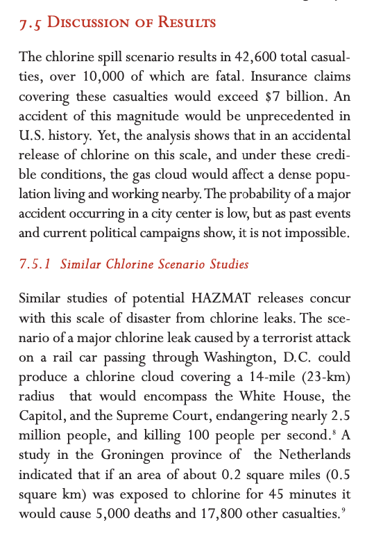

Burning creates a rising fire plume that carries the toxic components upward for safer dispersion in the atmosphere. The 1979 Mississauga rail disaster reportedly would have been much more serious if the burning propane cars hadn't helped disperse the chlorine, which otherwise could have spread along the ground in a toxic heavier than air cloud over a wide area.
Example of worst case modelling of a chlorine tank car release, for the insurance industry:

I know well the effect of a Cl2 railcar. I was in Columbia SC when a derailed Cl2 railcar killed 9 people.
