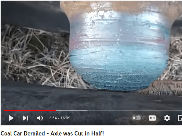

Dave with the Cumberland Mine Railroad posts some information about hot box detectors. Dave is of the opinion that the failure could have been either a failed axle bearing or hung up brake rigging. Either can result in axle locking up and wheel skidding, to the point of derailment.
A Failed Defect Detector and the Train Derailment at East Palestin
It is perhaps important to note that the Cumberland Mine Railroad while being a class 1 railroad does not have track connections to any other railroad. It is a coal only railroad.
This clip was posted after a derailment (Cumberland Mine Railroad) that resulted from a defective bearing that did not lock up the axle. The bearing end of the axle was cut completely through.
Coal Car Derailed - Axle was Cut in Half!
This is a typical result of an undetected bearing failure that does not lock up the axle. ( Cumberland Mine Railroad)
