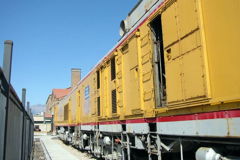

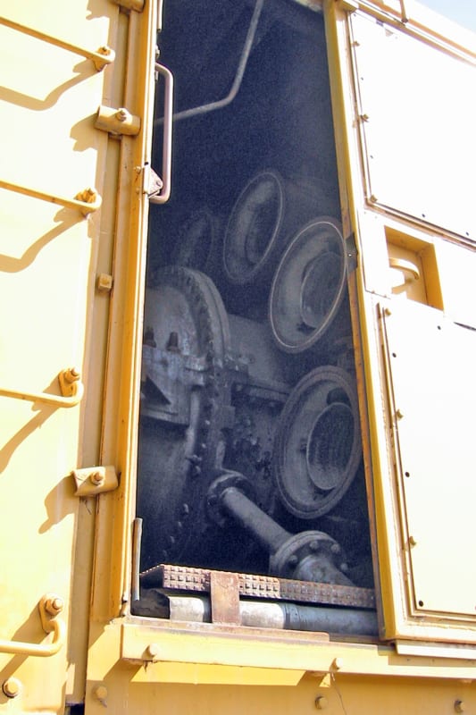

Speaking of "turbine locomotives", in Ogden, UT, at the old Union Station, which is now a museum, they have on display one of the two remaining examples of a GE Super Turbine Locomotive:
September 2008 (Canon IXUS V)

Turbine powered locomotives cost less to operate than the UP steam engines they replaced, but are not economical when compared to the diesel locomotives that were put to work in the i960's.
All of the EMD (now progress rail / caterpillar)current offerings for North America are listed at 4300 or 4400 HP.
GE Rail (now WABTEC) most popular locomotives are also this size, but there is an offering at 6600HP
