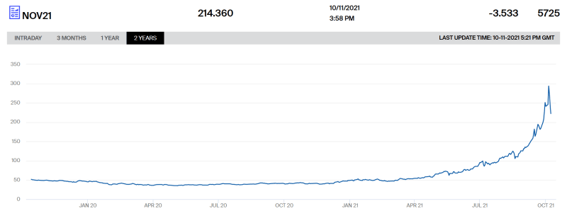

The energy crisis looks like it's going to develop into a full-blown catastrophe, yet there is very little media attention. For those not aware, natural gas & electricity prices are at record levels and we're only one week into the "heating season".
UK gas prices reached £4/Therm, equivalent to $54/MMBtu (no I didn't misconvert that, but I'll understand if you feel the need to double check).
Electricity prices are at astonishing levels right across Europe.
Ireland seems likely to be the first to fail as they're at the end of the gas supply chain and currently have the highest electricity prices.
This winter Europe will be at the mercy of the weather, mild & windy and it may be ok. But if it's cold, the level of disaster coming is hard to conceive.

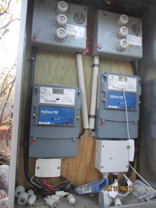

My neighbor in the summerhouse has put in solarpanels.
I think this picture is taken before that, seem to remember the last time I was in the box there where a signs saying it had a "back feed" on his fuse box.
And I have cleaned up the box since the electrical company did bother with it after they where finished. [mad]

The extraordinary gas spot market rates show no real signs of slowing down.
You can't blame too many people for looking at this prior to middle of this year and thinking the price is pretty steady at ~50p/therm and now over 200.
We had better hope the wind starts blowing pretty steadily...
