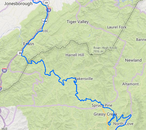

CSX Transportation’s ex-Clinchfield Railroad mainline along the Nolichucky River is in need of substantial rebuilding. Just like I-40 the route is dictated by the grade, the alternative would be crossing the mountains by tunnel as in the new Gotthard_Base_Tunnel, which is 53 miles long. Tunnels this long have only recently been possible, and tunnels this long only work for thru traffic. Time to construct 17 years, time to arrange funding may have been longer.
Here is the best current description of the Nolichucky River corridor. Stew Winstandley Sep 28 #713 Approximately 40 miles of railroad have washouts; region is still largely inaccessible
