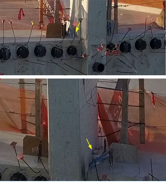

Gwideman...your picture
As mentioned in my last post...the area you have blocked out in blue...there is a square block of concrete gone in the top section of the deck. The pipe 2 on each side of member 11 have not been grouted. It looks like 11 sheared and punched out a square. This is punching shear except it is in the horizontal plane not the vertical. This piece of concrete is what we see in Meerkat 007 video at 0:17 seconds protrude out horizontally in line with the deck.

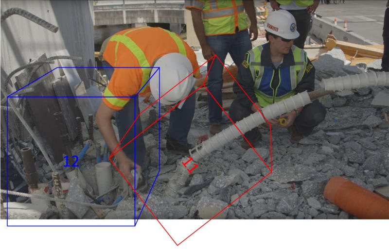

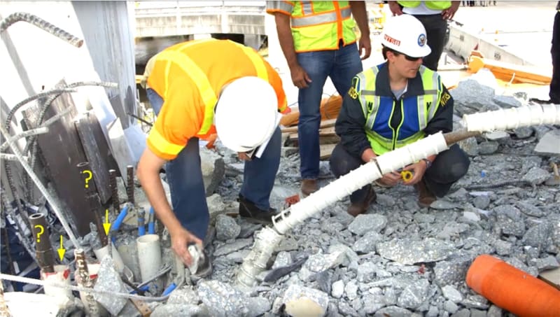

Where are the rebar linking No. 11 and 12 with the walkway?
The following photos were provided by gwideman on 23 Mar 18 10:54
They depict the locations of four plastic ducts, two on each side of No 12, before the collapse.
After the collapse gwideman showed the walkway deck with rubbles. The deck rest on the ground and tight against the abutment wall after the collapse.
The four plastic ducts are now visible but No. 12 member has gone. The long PT duct shown belong to No. 11. Thus the original footprint of No. 12 and 11 on the deck is in the above photo.
VolsCE84 has drawn the positions of No. 12 & 11 but his diagram appears too large and covers the 4 plastic ducts.
Do we not expect some reinforcement linking the No. 11 & 12 with the deck? The short vertical steel bars were started bar cast outside the No. 11 & 12 according to the first two gwideman photos.
I found it disturbing that no significant reinforcing bar from No. 11 & 12 embedded in the walkway deck. Anyone care to comment?

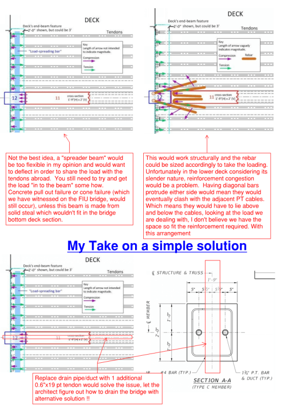

Regarding 11-12-deck, I wonder if a structural engineer might comment on how such joint systems work typically? What they might expect to see inside this bridge?
Ok, sure, I'm a Structural Engineer, see right at the very bottom for my solution and what I would expect for the joint detailing.
gwideman said:
So perhaps the idea is like in the following image: #11 presses on the deck end beam, which in turn acts as (or contains) a very stiff bar distributing the horizontal load to the tendons. Is that feasible?
gwideman said:
Or might the horizontal load from #11 be constrained by rebar that folds back south (rightward) into the deck for some distance: Either rebar in #11 folding like a hairpin under #11 into the deck, or L-shape rebar, with one leg vertical in #12, and a horizontal leg into the deck. Those horizontal legs in the deck could be long enough to spread compression broadly into the deck, to be resisted by the tendons?
Please see under for my comments on your schematics.
Bare in mind that according to my numbers, we only need one more 0.6"x19 Tendon running straight through the middle for the joint to work.

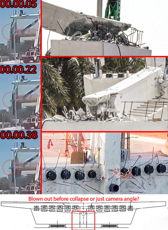

INCENTIVE said:
Is it the consensus that the concrete seen protruding half a second before the collapse is just the camera angle/illusion?
In my opinion it would be extremely hard to critique the failure mode of the bridge using the video footage alone, considering the footage was taken so far away.
Deflections and yielding of only 10mm would be enough to start a collapse of such a structure given that if is a truss and is not designed to bend primarily.
I don't believe the investigators would use the footage as a large percentage of support evidence in their findings, just to back up theories. At the end of the day, everything should (and can) be proved theoretically given the as-built drawings and an engineering analysis. I must stress again that this is not a complex sturcture and indeed a truss is something we all learn in Engineering 101 at university. Someone indicated previously that "months of analysis" would be needed to check these things, this is simply not the case. Engineers are not scientists/chemists, we like things to be simple, simple to build and simple to analyse. I am relatively comfortable with my pen and paper appraisal which took me 15 minutes to scribble to determine that there is a potential problem with the support node at junction 11/12.

SheerForceEng,
Re-examining the drawings I tend to agree with you that congestion will be a problem if the designer details some rebar from No. 11 to pass the stress into the deck. The transverse and longitudinal PT systems effective form barriers difficult if not impossible to thread through large diameter rebar.
Apart from using the drainage pipe position to add an additional PT line which will certainly help the situation. An alternative is to pass the rebar from No. 11 into the downstand section which some call end beam that has a beefy dimension of about 18'2" long by 4'2" deep by 2'10" wide. The end beam embeds all the longitudinal PT anchors below which there is ample space to bond reinforcement from the No. 11 to develop their full strength.
Another alternative is to weld a piece steel plate to say two sets of anchor PT plates on either side. The steel plate has to be at least same thickness or thicker than the PT anchor plate. If No 11 shear outward they have to take out at least 4 sets of PT tendons. To avoid bending the additional plate needs stiffeners which can be embedded inside No. 12.
The vertical member No. 12 can also be made strongly connected to the end beam to form an effective restraint or buttress.
I believe as an engineer we could all find different solutions to make a stronger connection for No. 11 & 12. The question now is has this connection been adequately designed or not overlooked.
