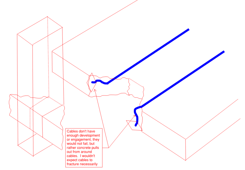

appster said:
I believe that the picture of the bottom deck in Incentives post above clearly shows that the tendons in the deck or the deck itself did not blow "out the back" but that section 11 and 2 sheared cleanly off at the deck due to inadequate shear capacity.
I agree with your first comment regarding the cables blowing out the back. I don't think the cables went anywhere at all, but rather the concrete would have blown out sideways as this is where the net load direction is headed. Because the cables aren't adequately embeded in the concrete its a "pull out failure" rather than a tendon breakage failure.
Be carefull when talking about shear. Even with temperature effects and shrinkage taken into consideration, a well detailed and designed truss should have nominal shear/moment in its members especially when compared to the tension/compressions experienced in the members themselves. Therefore the primary forces acting within the members is tension or compression with some incidental shears and moments thrown in (again if detailed and designed properly!!)
I know this is semantics but regarding shear "failure", if member 11 and 12 were to shear off the deck (say the top surface of the bottom deck is the shear plane) then this is a very large cross sectional area for shear to act over. With "cone pull-out failure" the concrete is actually acting in a combination of shear and tension, as we all know concrete behaves terribly in tension, so the capacity of this failure mechanism is much lower than say pure shear of the cross-sectional areas from 11 and 12 interface with the deck.
However at this point I believe we are splitting hairs and there may be elements of both failure mechanisms (pure shear of members 11/12 as well as pull out cone failure) occurring, especially when yielding occurs and the system tries to find other load paths as things turn south.
The trouble with looking at the failed structure only is that it doesn't give a good indication of what gave way first, other failure mechanisms would come into play, but generally after the first domino has been knocked over so to speak. This is where the analysis of the as-built structure (in theoretical terms) will be key to the investigation... numbers don't lie, images can.

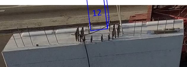

Meerkat 007 said:
24 Mar 18 23:47 3D model of 11-12-deck joint superimposed on the NTSB rubble photo
Thanks Meerkat, excellent visualization. As we have been deducing here, based on the positions of the white pipes/sleeves adjacent to #12, my original visualization of that area had 11 and 12 drawn too large. It was on my mind to revise it, but yours is better.

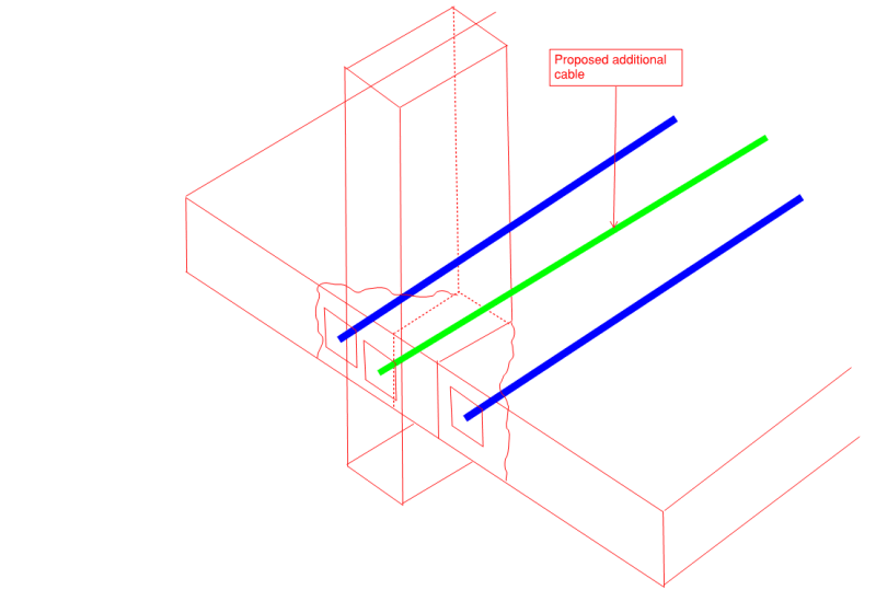

SheerForceEng said:
24 Mar 18 22:40 see right at the very bottom for my solution and what I would expect for the joint detailing.
Responding to my questions to structural engs about how they would expect a joint like 11-12-deck might be designed to work, specifically how stress finds its way from #11 to the deck's tendons.
Thanks for that discussion, very informative.
Lnewqban said:
24 Mar 18 14:05 Suggests adding a "horizontal member" with PT between 11 and 10 at deck level..
This parallels the solution suggested by SheerForceEng.

waross said:
If the 11-12 connection had been blown out very much, would there not be a tendency for it to be hooked behind the support column instead of resting on top of the column?
No I beleive the node itself (intersection of 11, 12 and deck) would stay in place and not move.
Instead, once cone failure occurs, the bottom deck would tend to pull inwards towards the centre of the truss. Bare in mind that the bottom chord is in tension and is somewhat stretched, once connection with the support node is compromised, it wants to head away from the node becuase it wants to shorten and sling back to a non-stretched state, the node could stay where it is (hence why it remained on top of the support pier).
Also the entire truss is quite adequately supported laterally at its other end, meaning that for the vertical member 12 to end up on the outside of the support column would meam that it would have to pull the whole truss with it and the support at the other end as well to achieve this outcome.

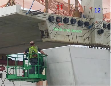

Any scenario has to explain how the bottom end of #11 and #12 managed to remain on the top of the pier when the deck fell/dragged off the pier.
Members 11 and 12 were not only connected to the deck and end beam, but they should have been connected extremely strongly, for several reasons:
1. To contain #11's longitudinal force, which amounts to a large horizontal force, plus a vertical force that amounts to half the weight of the bridge.
2. That vertical force does not even transmit directly down to the pier:
The end beam of the deck, which is integral with the base of #12, rests on nylon/teflon blocks, presumably to permit some sliding to accommodate positioning or expansion/contraction. These blocks are outboard of #12, so #12 is essentially suspended above the pier, and that 12-11-beam-deck joint should be strong enough, in multiple directions, to accomplish that.
Yet somehow, before the deck falls, #12+#11's friction with the pier, to which it was previously unconnected, proves strong enough to overcome #12-11's attachment to the end beam and deck.
I think this argues in favor of #11-12 first becoming disconnected from the deck/end-beam, dropping an inch or two onto the pier, and then the deck sliding off the top of the pier. And therefore that actually #11-#12 was not sufficiently connected to deck+end-beam.
Another conjecture:
About the only part of the 11-12 connection remaining with the deck is the lower PT rod.
Possibly the crew did everything correctly and removed the nut without incident.
However, when they then relieved the tension, the strength of the main connection between 11-12 and the deck was lost.
As the deck dropped, the bottom ends of both 11 and 12 were destroyed.

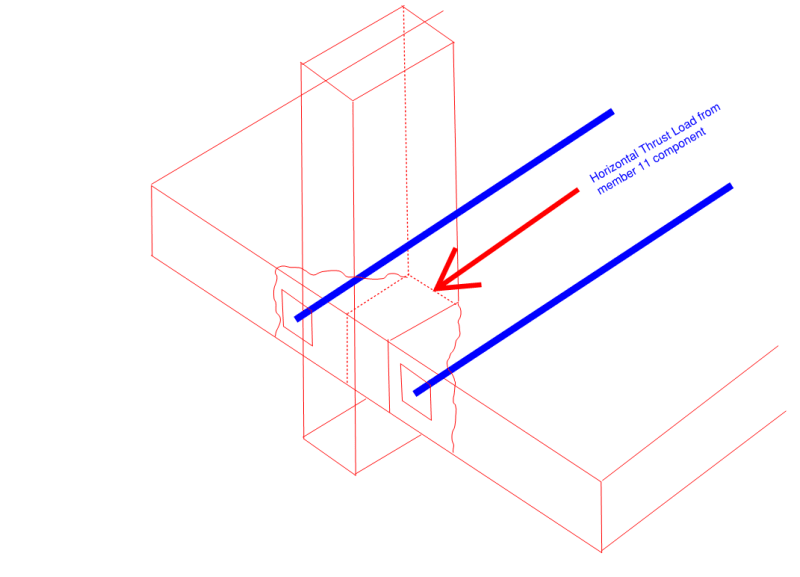

Using the approximate footprint of 11 and 12 combined from the picture which is about 60" long and 22" wide the interface shear area is about 1584in2. The approximate horizontal component to the thrust in 11 is 1520 kips. Nominal shear stress then is about 1.0 KSI or 1000 psi at the web bottom flange interface. This is a scary number when you consider that AASHTO for Horizontal Interface Shear allows max. 80 psi x bd with no shear reinforcing, 350 psi x bd where minimum with minimum vertical ties (shear reinforcing) are provided and 330 x bd + 0.4 A fy x dv/spacing
If we use a simple value of square root of F'c (an old value) then assuming 5000 psi concrete we come up with 70 psi for plain concrete. Obviously the concrete needs full mild steel reinforcing to transfer the shear load, I do not see that anywhere in this structure at the web members, either at the deck or in the caps and canopy.
Adding approximately 500 k more in horizontal component for live load still to be provided for, I really don't know what the designers were thinking.
Just to take this one step further I have estimated the total shear area using the section of the deck shown to the tensioning duct on each side and then then from the ducts at 90 degrees to sloped bottom edge of the deck as the shear plane as shown. With a total perimeter of about 15' or 180" and shear plane through the deck of about 22" the total shear area is about 3960 sq. in. If the DL hor. shear in 11 is about 1500 kips then the stress is 380 psi horizontally and 950/3960 = 240 psi vertically requiring serious shear reinforcing and with DL+LL (2000 k hor.) approximately 505 psi and (950+317)/3960 = 320 psi vertically. Still have no idea what they were thinking.
[URL unfurl="true"]https://res.cloudinary.com/engineering-com/image/upload/v1521955954/tips/part_section_ym7zqf.pdf[/url]
