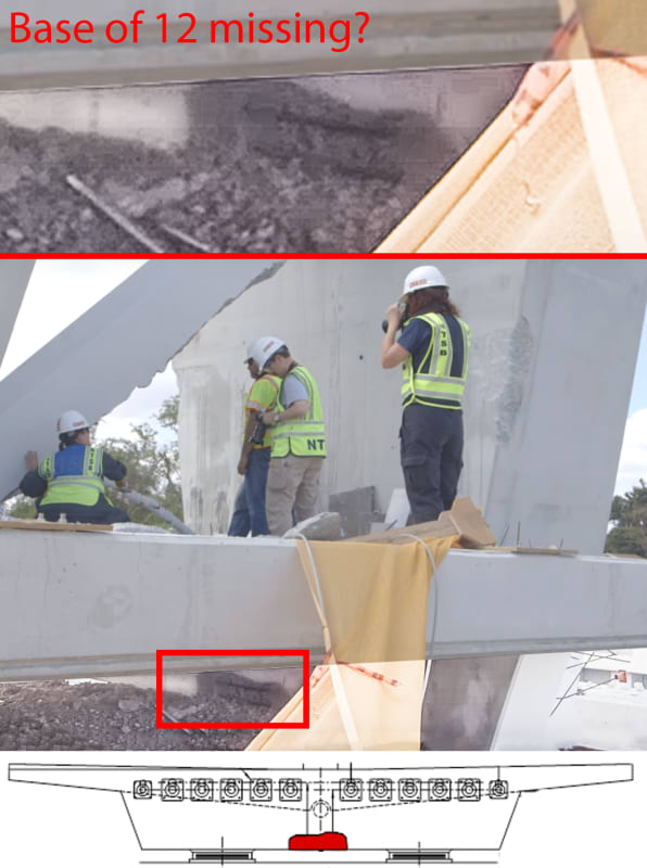

I also found some photos that look like they might show the base of 12?

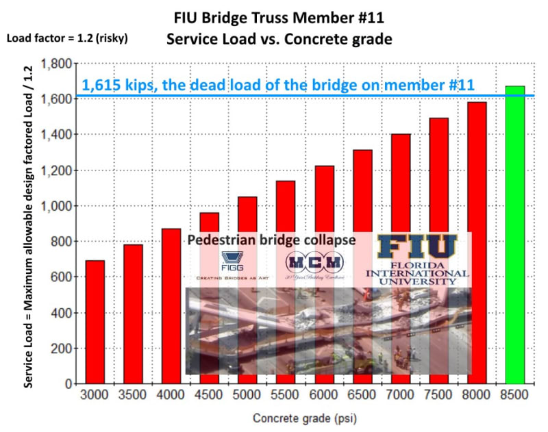

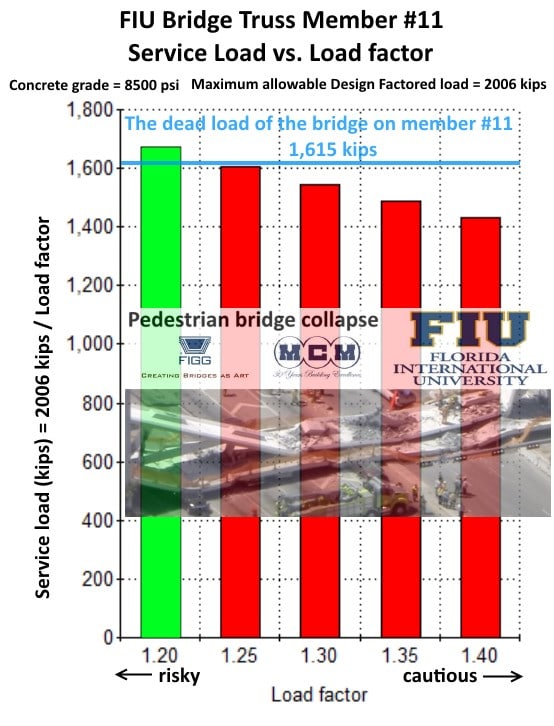

2,200 kips is not "okay" for member #11. Far from it.
When calculating the maximum allowable design factored load for a concrete column there are other multiplication constants which reduce the design load considerably, as these university lecture notes explain.
Here's a worked example from the same notes, which I have written on top in red ink to calculate the factored load for member #11.
So member #11 is good for a maximum allowable design factored load of only about 2000 kips.
Then you have to divide 2000 kips by a safety load factor to estimate the maximum service load and then you find that the dead load of the bridge alone is barely "okay" for member #11.
This tells us that only calculating with a risky safety factor of only 1.2 can we assess that the truss member #11 is just barely strong enough to hold the bridge up with no additional load from post-tensioning bars or from any pedestrians on the bridge. Using anything more cautious for a design safety factor would warn that the bridge is at an unacceptable risk of coming down.
Of course it would be much worse if there were any issues with the concrete not being as specified.
So we can see that the bridge designers were gambling with people's lives even before a single PT bar of member #11 was post-tensioned.
What is the code required safety factor to use for self weight (or dead load) for this specific application in the US? In Australia it would be perfectly acceptable to adopt a safety factor of 1.2 for dead load under ultimate conditions.
** Edit** I should clarify that actually in this specific case considering there is little/no live load present, a load factor of 1.35 in accordance with Australian loading code would be the governing case
This is partly the reason why a reduction factor of 0.65 is factored into the column design itself.
Do we know how much stressing was applied to these temporary PT bars? They may have chosen to only moderately stress these bars to reduce unsightly cracking in member 11 due to temporary tension loading during lifting/transport, there may not have been a reason to wind them all the way up to 70/80% of breaking limit as per standard, especially if they knew that the loading in this member was designed so lean (which hopefully they did know).
Overall you may have simply proved that the design was economical in nature and not "over-designed". With the compounding safety effects of the 0.65 reduction in member capacity as well as over-estimation in applied load of 1.2, this appears to be code compliant (noting I'm not intimately across the US concrete/loading codes).
With the capacity being very close to the final case loading however, there may be some merit in the assumption that the designer assumed that the CHS cable stays do in fact share some of the loading in service conditions.
The applicable US code would be AASHTO LRFD. The load factor on DC (dead weight of components, i.e. self weight) is 1.25 for this situation. The load factor on LL, which was essentially nil at time of failure, is 1.75.

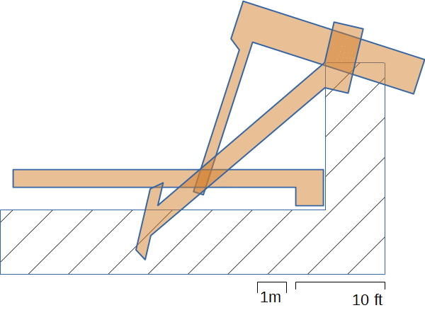

Member #11, #12, north deck and canopy position after collapse without deformation/destruction.
Any find something wrong, point me about please for recheck.

I'll recheck about PT rods as something on my working drawings not fit.

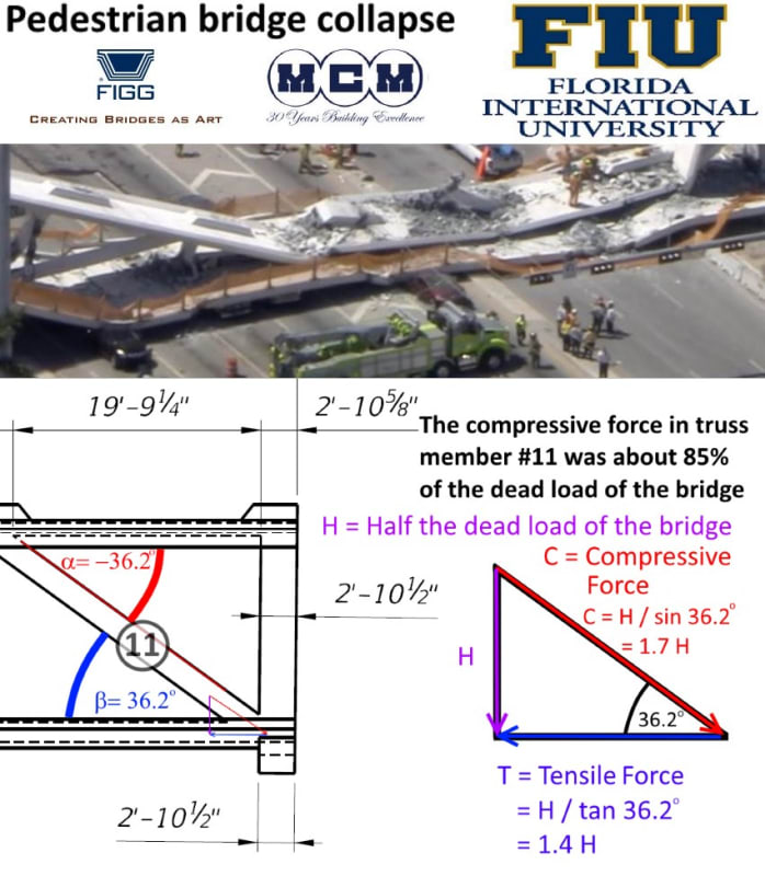

Diagonal #11 has a slope of about 1v:1.38h based on the prelim drawings. This results in an unfactored dead load force = 1619 kips based on the truss end reaction of 950 kips.
Columns that fail when tested to failure break at mid height. The end diagonal #11 did not fail in axial compression.

Member #11 is drawn in the engineering drawings at an angle of about 36 degrees from the horizontal, which is what Ingenuity meant with -
Ingenuity said:
Self weight support reaction of 950 kips and a member #11 angle of 36o equates to a compressive force of about 1600 kips
So "about 1600 kips" is right for the compression force on member #11 from the bridge dead load too, I agree.
Agreed.
Agreed.

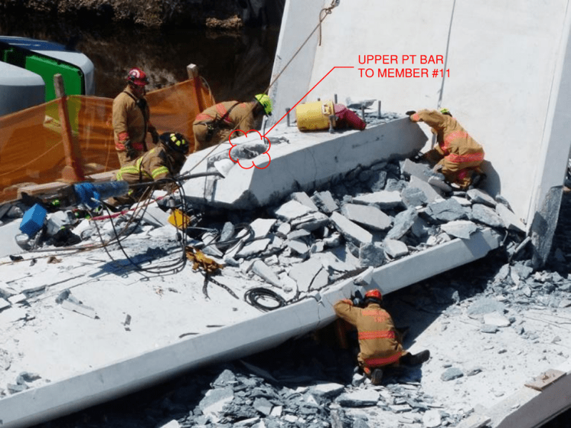

I wonder if the upper PT rod in member 11 was removed after it was relieved. Is it visible in any of the pictures?
No, it was not removed.
As per the following photographs of canopy blister and members #11, #12 and bottom chord:
From a practical point, PT bars with dead-ends, and contained withIN members of considerable length are a right-royal pain to remove. The engineers would have just left them there UN-tensioned and grouted them up.
