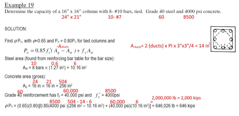

But let's talk about AASHTO equations. ø = 0.75, a realistic Aps of 1.75" dia rods & fpu = 150 ksi with a factor of 0.7 to reduce fpu to fpe.
Pr = øPn = ø(0.8(0.85f'c(Ag-As-Aps) + fyAst - Aps(fpe -Epεcu))
=0.75 ( 0.8 (0.85(8.5ksi)(504 - 10(0.6) - 2(2.41)) + 60ksi(10(0.6)) - 2(2.41)(0.7(150ksi)- 28,500ksi(0.003))
=0.75 ( 0.8 (3563 + 360 - 94))
= 2297 kips

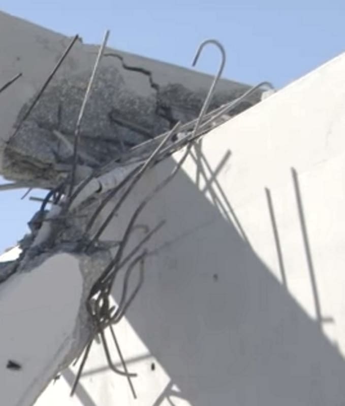

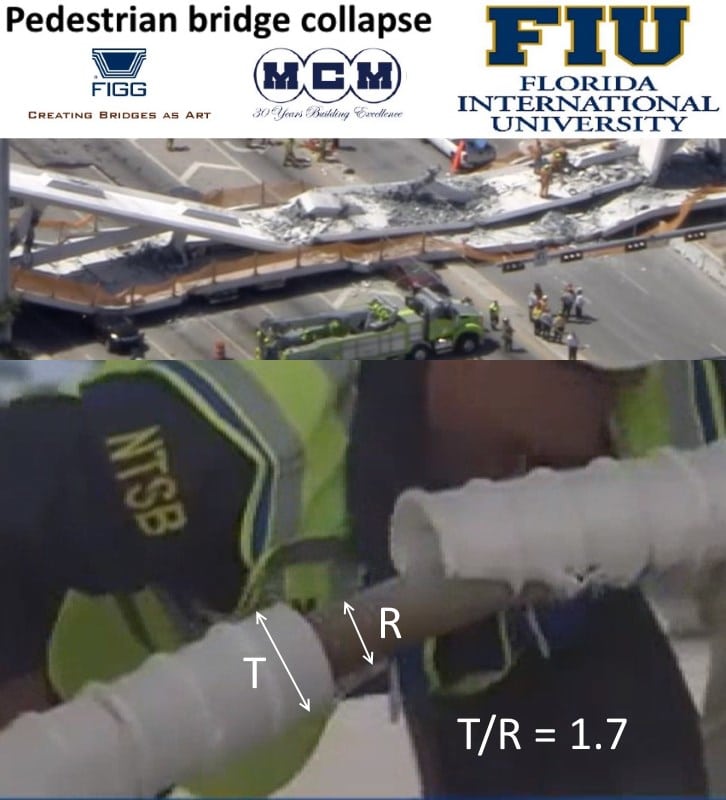

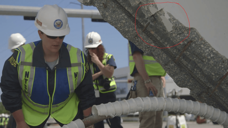

However from the following photographs, I've got something of an idea by estimating that the rebar used is #7, diameter 0.875", area 0.6 square inches.
This image tells me that the ratio of the diameter of the rebar "B" to the diameter of the plastic duct "T" is about
T/B =3.4
and this image tells me that the ratio of the diameter of the P.T. bar "R" to the diameter of the plastic duct "T" is about
T/R = 1.7
and by substituting for T we can deduce
R/B = 2
meaning that the diameter of the P.T. bar is about twice the diameter of the rebar.
If the diameter of the P.T. bar is 1.75" throughout as per the engineering drawings then the diameter of the rebar is half that or 0.875", number #7 rebar.
The number of rebars is more difficult to estimate but we can get an idea by looking at this picture which shows the smashed bottom end of member #11 with the exposed ends of the rebars and ties sticking up in the air now -
- by assuming that the ties are #4 (0.5" diameter) bar as per the engineering drawings and trying to count the 0.875" rebars we can see on one side and doubling up to get the total number of rebars, while not miscounting a 0.5" diameter tie as a 0.875" diameter rebar.
Unfortunately, there is not enough resolution in the photograph to be sure of what is a rebar and what is a tie.
What would help would be new high resolution photographs of that exposed end of member #11. If all the bars we can see sticking out are 0.875" diameter rebars then there is maybe more than the 10 I assumed.

And yes about 2000 kips is correct for the equation you used.
Thanks again bob.
Do you have a reference link and page number for those equations?

The P.T. bars are loose in a 3" diameter plastic duct with an area of 7" square inches each. So you have to subtract the area of the ducts from the area of concrete, not just the area of the P.T. bars. That's why I have "-14" in my equation and why you should have "-14" in your equation too.

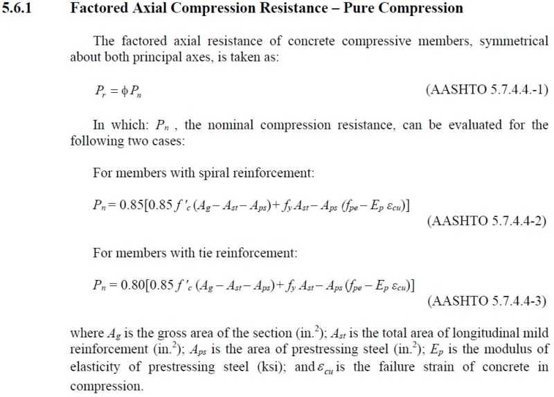

Best I have for a reference is other than the original paper AASHTO:
See Caltrans Section 5.6.1
references the equations specifically...
Equation AASHTO 5.7.4.4-3.

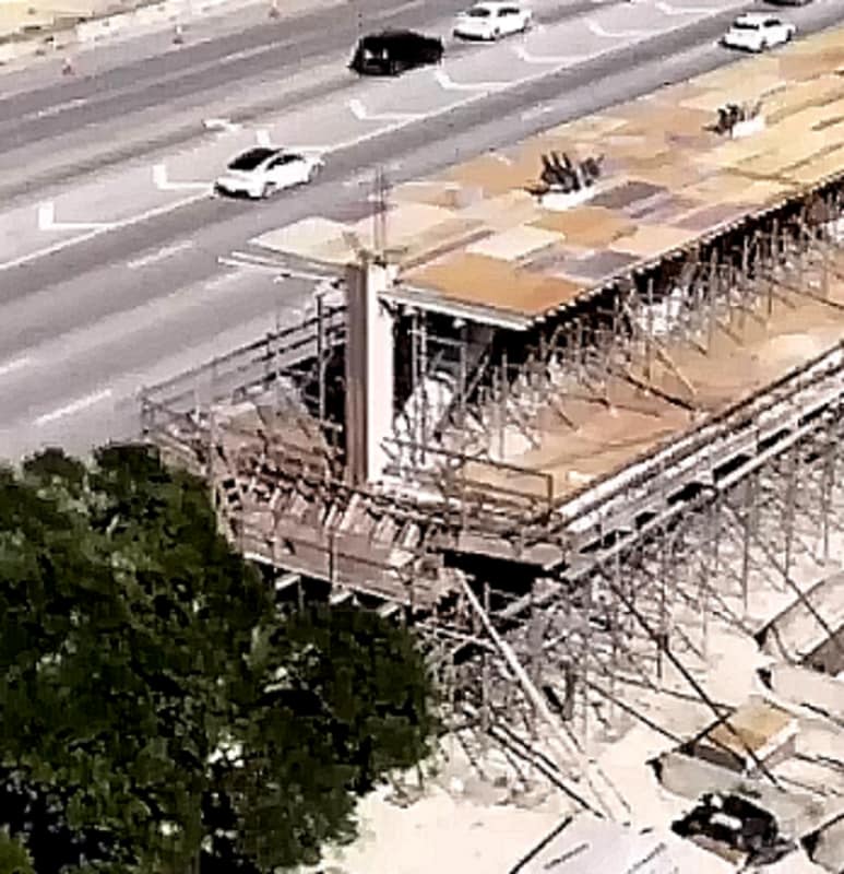

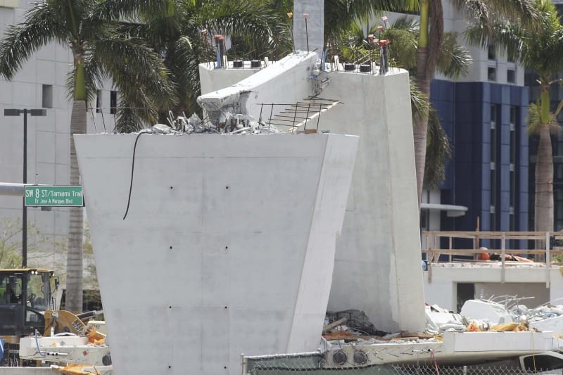

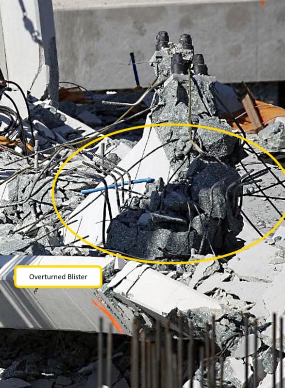

This is #2 during demolition. It is of course deeper in section than the rest.
The canopy appears to have been suspended from the top of each upper node.
Overturned Carcass of a blister.
Is is possible the canopy failed first?
It seems thin, 1/2 thickness of the side view and drawings show six longitudinal tendons near the edges but looks like four were installed.
Thanks. Here it is.
Calculating the factored axial resistance or factored load should treat the contribution of prestressing steel differently from post-tensioned bars.
It is not appropriate in my opinion to try to apply the term for prestressing steel in AASHTO 5.7.4.4-3 as if that same term could be applied equally to post-tensioned steel.
A prestressed bar which is embedded in the concrete behaves very differently from a post-tensioned bar in a duct. It is not the same calculation, at all.

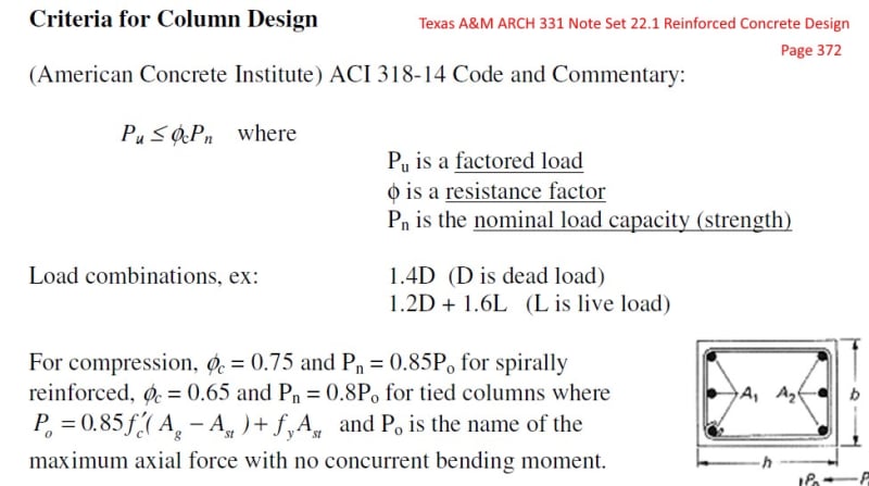

bobwhite said:
Of note I ran a quick calculation on the strut #11 last week with 1% steel using the AASHTO equations and the anomaly is that the phi factor = 0.75 for AASHTO is the same for columns with ties or spirals. I remembered a design force of about 2300 kips.
ACI has a phi factor of 0.65 for tie reinforced columns and a phi factor of 0.75 for spiral reinforced columns.
Between making a mistake with the equation you posted and the fact that I was too lazy to remember that ACI takes a double reduction for tied columns my initial post was inaccurate.
As specified here, on page 5-4, I presume?
Well I do not wish to venture a strong opinion tonight as to which equation's phi factor is best for tied columns, 0.65 or 0.75, all other things being equal.

Looking at the photos you used to estimate diameters the items being measured are not at the same distance from the camera therefore the PT duct to rebar diameter is not accurate.
Well my effort to provide an estimate for the rebar diameter I suggest shows more initiative than simply giving up saying "no idea" and providing no estimate whatsoever.
I would welcome a more accurate estimate - or better still an actual measurement!

Yes indeed and at the risk of repeating myself here is that calculation again.
Peter Dow said:
Here's a worked example from the same notes, which I have written on top in red ink to calculate the factored load for member #11.
So member #11 is good for a maximum allowable design factored load of only about 2000 kips.
saikee119 said:
Bearing in mind that there is a reduction factor φ so if the actual material were not under strength and dimensions were accurate the actual axial load capacity could be slightly higher.
Nevertheless, the design equations which engineers use employ φ factors for a very good reason.

The maximum allowable design factored load I calculated, 2006 kips, was nothing like "twice" the unfactored bridge load on member #11 which I calculated, 1615 kips.
If you want to know, the ratio of the two figures I calculated is 2000/1615 = 1.24 - which is not an impressive safety load factor, not when you consider that additional load from post tensioned bars and pedestrians will be adding to the bridge dead load on member #11 and further reducing the safety factor, perhaps to below 1, which is no "safety" factor at all!

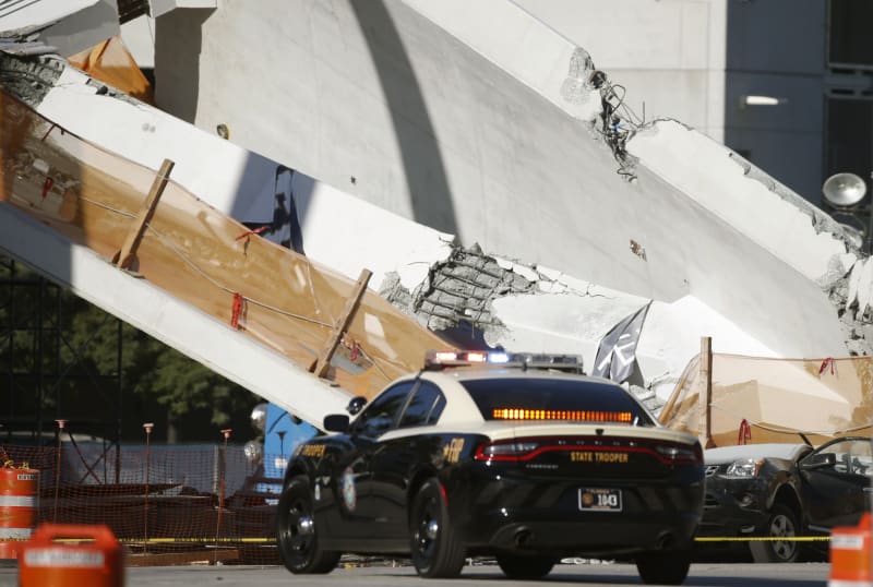

The photos do indicate the body of No. 11 is still intact apart from the bottom PT duct has been ripped out
Well the top and bottom joint of member #11 look to be destroyed too.
saikee119 said:
which I suspect to be a consequence of dropping the walkway to the ground thereby pulling the PT duct out of its concrete cover. The breaking of the stirrups might have help the whole face detached. The stirrups clearly were rib open by tensile force.
That's one reasonable theory admittedly. There is the other theory that the P.T. bar snapped while being jacked and so it would be very interesting and conclusive to know if the P.T. bar concerned is still intact or not?
