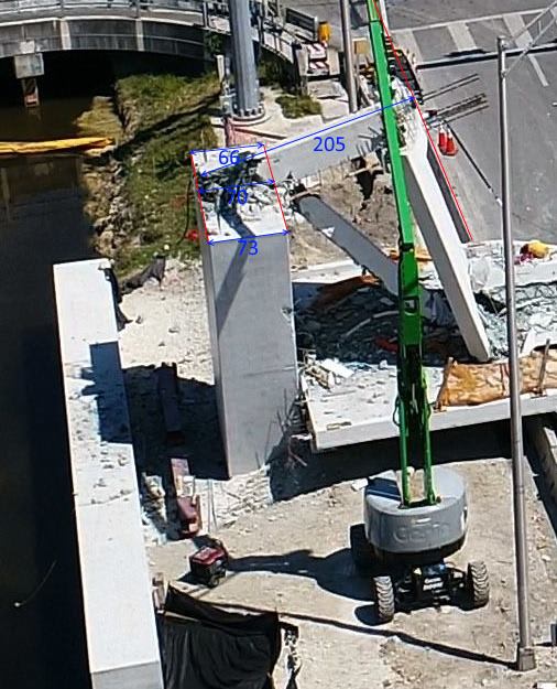

In your post referenced above I see an opportunity to pretty well estimate the remaining length of member 12. Using a ruler and scaling the 6 foot pylon as 10 - 1/8" divisions and the length of 12 as 26 divisions my crude methods suggest the north face of 12 is 16 feet + long. (hard to pick a measuring point for the top at the canopy).
Can any 'vid gurus' improve the accuracy - or is this close enough?
If the (now) north end of 12 was the top of the deck (joint) that should tell us something. Perhaps of no importance, but something.
Here is my attempt. The units are pixels.
If the pylon is 6 feet I measure the 205 pixel long arrow as ~205/70 = 17.6 feet
No adjustments made for parallax. Just a simple scaling

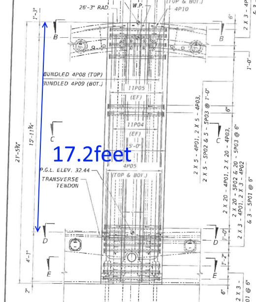

According to drawings the top of canopy to deck dimension is 17.2 feet. This would suggest the damaged 12 member we can see is approximately full length?
Vance Wiley (Structural) Thanks for your probing question and estimate. Tomfh (Structural) Thanks for showing your work. It seems to show that the north face of 12 remained largely intact. I seem to remember that the rebar going up into 12 remained straight up in the top of the diaphragm. I also observed what I interpreted as a cloud of debris on the deck expanding in a couple of frames of the dashcam video (about the time I interpret 12 to have just started to tilt (top of 12 barely visibly south of its previous position)). Photos of the NTSB examining the north deck seem to show both ends of 11 damaged, so I'm having difficulty determining how much of each end of 11 disintegrated. So, I find myself asking, was the compression in 11 enough to cause it to explode, or did it require 11 to gain some momentum, or what?
