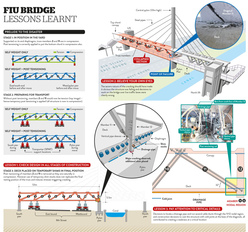

It is unfortunate that alleged improper construction led to cracking.
Allegedly responsible experts examined the cracks.
The alleged experts then dismissed the cracks as unimportant and gave orders that resulted in the destruction of the bridge and multiple deaths.
The contractor may have made an expensive mistake but he was not responsible the death and destruction.
That is on the alleged experts.
Bill
"Why not the best?"
Jimmy Carter
"Very sad that FIGG (EoR with significant past-experience as a senior bridge design engineer) personally witnessed that degree of cracking/distress then attend a meeting stating:"
Certainly not to defend anybody but you have to remember that while he was a well-qualified senior bridge design engineer he nor anyone else had any experience with a breach of this type. As a matter fact since most of their experience was with steel construction for bridges there overall view of what was a problem was probably somewhat distorted.
Then don't design a bridge of that type.
Either you have prior experience, you have a solid grasp of the fundamentals to assess new situations, or you don't perform the work. Basic engineering ethics.
I agree that FIGG and Pate's reputations only get more soiled the more we learn.
just call me Lo.
"Alleged improper construction" is just an attempt to deflect. This was design error, pure and simple. Then stupidity/negligence in not closing the road.
There are no excuses for any of the experts in charge not knowing the cracking was an issue. Just from the pictures, I can easily tell that the cracking clearly showed member 11 was trying to exit the bridge through member 12 and I've never done any work with structural concrete.
An 4th year undergraduate student in any engineering program - even 'blind-Freddie' who could place a finger 4" into the cracks - would have done something more than attend a meeting and state it was all-good, then jump on a plane back to the office and text Linda Figg that the “meeting went pretty well”. Sheesh!

As well as their other shortcomings it may be argued that Figg failed in their due diligence in that they did not inspect and verify that a critical surface was adequately roughened.
Bill
"Why not the best?"
Jimmy Carter
I believe they've blamed the construction management group for that oversight. If your entire structure relies on friction due to a roughened surface, it looks worse for Figg/EOR to say they didn't have that inspection in their scope (or whatever their excuse is).
From Figg's party submission to the NTSB relating the events on the morning of the collapse, their own words:
"Figg left the site to return to Tallahassee to develop a way to enhance the north end truss member connection at this stage of construction."
Why? If all was well and good and no one had any concerns, why?
