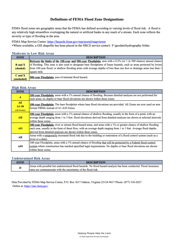

A possible consideration is that the definition used for a flood zone which works OK in areas where the risk is storm surge, may be wholly inappropriate in Appalachia.
FEMA 100 year flood definition. said:
0.2 Annual Chance Flood Hazard,Areas of 1% annual chance flood with average depth less than one foot or with drainage areas of less than one square mile Zone X
Perhaps in these areas less frequent flood lines should be identified on the maps.
The recent event flooded much of or in some cases beyond zone X which is defined as minimal hazard.

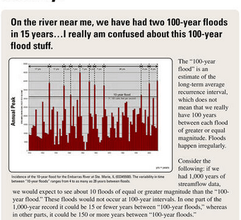

This is likely a flaw in our implementation of engineering related to Noaa Atlas 14 Point Precipitation Frequency Estimate. The return frequency tells us only about spot of interest, it tells us nothing about the frequency of return in larger areas, such as a watershed.
Continental Scale Regional Flood Frequency Analysis seems to be an area of active research.
The USGS does publish Flood Frequency Reports (this is the first time I hunted for this page).
This explanation is offered on the subject of return frequency.
100-year-flood-its-all-about-chance
LINK
Making informed decisions from these reports is impeded by the reports defiantly being NOT user friendly.

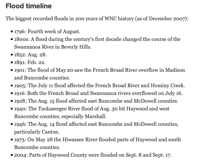

The western NC flooding is not really unexpected. The same thing happened in 1916 to Asheville. They thought they were more ready this time, but preparedness cannot always overcome Mother Nature.
