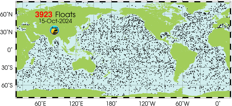

If it is the total energy below the unit of area that can't be known because there are only comprehensive measurements of surface temperature. We have a centuries worth of bucket dips but the sampling rate isn't high enough to make meaningful trends.
MTG SATELLITES (Yes Seriously MTG [clown] (Meteosat Third Generation)
ARGO FLOATS
How Do Floats Work

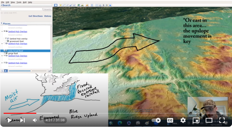

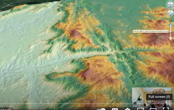

What's the elevation difference of the uplift, +/- 1500ft?
The valley behind and along the ridge looks a lot like the Derna, Libya topography that washed out last year.
Elevation at Rutherford NC ~ 700 ft (Piedmont)
Walnut creek at green river - 800 ft (downstream end of gorge)
Adjacent Blue Ridge escarpment - ~2500 ft (typical)
Adjacent mountain tops ~ 4000 ft.
This is enough elevation change to wring water out of clouds.
Elevations from USGS Topo builder

2500 -800 = 1300 ft. =+/- 1500
From my local weather experience with a 1500 ft vertical cliff to long ridge at the top only a mile away that its enough to drop the temp 1.5°C 3°F and that will condense and dump a big share of the water vapor. I figured the same happened at Darna. They also have a large and long catch basin paralleling the ridge that drains into and through the city.
