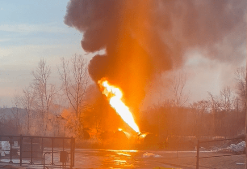

Note the mention of extremely low temperatures.
I suspect that is the cause*.
And I suspect the train crew should have been told to operate at restricted speed, because of that possibility.
And/or the trackage should have been installed taking into account these temperatures.
spsalso
*I'm talking about the effects of rail contraction at cold temperatures. A rail joint could have failed. Or rail could have been pulled up on a curve. I suppose a rail could even have snapped.
Besides restricted speed, there's also the running of an inspection car ahead of the train.

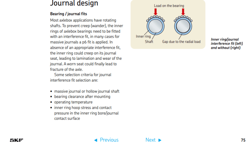

You used a press to install bearings and not heat? No hydraulic expansion?
Tug,
The wheels are pressed onto the axles--no bearings involved. Yet.
After that's done, the journals are projecting out from each wheel face. The bearings are slid onto those (I assume, rather than pressed), and the truck frame is dropped down onto the bearings.
Here's axles with wheels pressed on:
Note the projecting journals (without bearings).
spsalso
We fit similarly sized shafts in similarly sized gears for our marine transmissions. It's all done with heat, though. No pressing. There is too much risk of galling at that level of interference.
Bearings are the same, heavy interference on the inside race, too much risk of galling. Newer systems are often drilled for hydraulic expansion but I don't see any such system on train wheels or bearings.
The press is usually used to hold the bearing against the step while it cools as they tend to walk as the shrink.
Port and bridge crane wheels get pushed onto their axles the same as railway practice. A good press lubricant is vital. In the late 1970's we used white lead and tallow, now the mechanics often use copper / oil paste (CopperCoat FelPro or somthing similar).
I think the roller bearing journals are a light interference fit.
